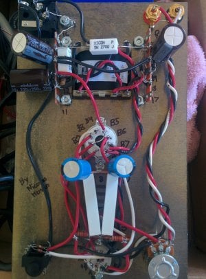

Yes, all my measurements are approx. 0v and I am sure I am measuring in DC. I do not have a clip lead but I am making sure to correctly place my black probe on terminal 12 or the ground wire.
Here is the build, sorry it's messy it's my first time soldering

Switch you meter to read AC volts. If it has voltage ranges set it for the highest one. With the amp unplugged carefully clip lead the black test lead to power transformer terminal 10. Carefully clip lead the red test lead to power transformer terminal 9. Plug the amp in, switch it on and you should see roughly 150 to 165 Volts AC across terminals 9 and 10. That means the high voltage secondary of the power transformer is working. If you get zero or very close there may be a problem with the connections there.

Hey Doc, I do get a 0 reading on those terminals. Let me try to resolder and retest and I'll update. Thanks.

Hey, so now I get a 1 reading on AC Volt reading after resoldering. What could be wrong?
EDIT: Hey good news, so i don't know what I did but I redid some of my soldering and I'm getting correct voltage readings. I got every reading correct except at terminal 21 where it jumps to 200 then goes back to 1 consistently, then I saw a spark and unpowered the amp immediately. What is the issue?

Your meter is most likely in a 200V range, and it is sometimes able to resolve a reading at terminal 21, and at other times it goes over limit, which it displays as a 1 on the left side of the display (as opposed to 1V, which would be a 1 at the right side of the display).
The spark was most likely caused by your probe slipping. This is why we suggest using clips to secure your probe. Go to RadioShack and buy some. I will postulate that most of your measuring issues have been caused by an insecure probe connection, rather than a faulty solder joint.
