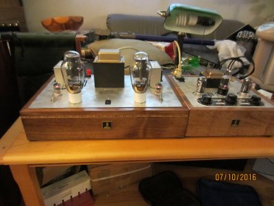

Finished my stock kaiju today. No problems with the 1.5 fuse. I'll upgrade the caps and other stuff later. I'm breaking it in for now.
Fred
Almost forgot to mention this but I used 2% silver solder for the entire build. Maybe that's why I got away with the 1.5 fuse

Looks good! I don't think silver solder had anything to do with it other than being a pain to work with.  Happy listening!

I did the DC filament upgrade and the clarity output cap upgrade and sure enough the 1.5 v fuse blew.I'm now using the 2.5 slow blow. Seems to be doing ok.
Fred
I did the caps first, the 1.5 held. After the DC filament upgrade the 1.5 blew.
