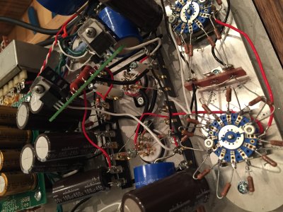

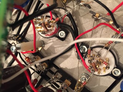

One of the pins broke inside the 9 pin tube socket while I was trying cleaning them
I ordered new ceramic 9 pin sockets and re-installed.
Resistance readings are fine but I am getting
T 11: -.367 VDC
T14: -.773 VDC
All other VDC readings are within range.The LED near 1B on the PC board is not glowing. I've triple checked all the connections and wiring. I switched tubes and ordered and installed replacement resistors for both driver tube sockets without any luck.
I have the DC filament supply installed on my stereomour and previously everything was working fine before the new sockets.
Any ideas or suggestions would be greatly appreciated? Thanks.

Testing the red wires coming from T27 and T34 and going to IB and IA, I am getting 405 VDC from each - this seems okay. Also, I removed the white wires coming from the PC board going to T7 and T14 to test the VDC output. From OA I am getting ~405VDC and from OB I am getting less than zero.
Maybe there is something going on with the components of the PC board?

Can you carefully measure the DC voltage at C3?
Generally, having about 0V at OB/14 means that there's a short to ground on this connection. You may need to unscrew the board, lift it out of the way, and take some photos.
Was this amplifier working to begin with?

Yes, The amp was working before I replaced the sockets. I'll take pictures and test C3 when I get home tonight.

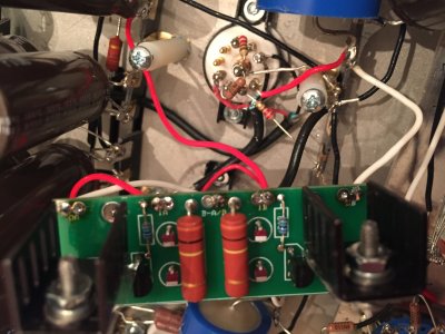

The two LEDs on the source side are not illuminated.
C3
.049 VDC

I haven't had very good results with the sockets you're using. You may find that putting the stock parts back into your amp will solve the problem.

What DC voltage should I be looking for at C3? Is the short to ground likely happening at the socket? Are there any other measurements I can take in this area to understand better the issue?

In a working amplifier, you'd see about 200V at C1, 0V at C2, and 2V at C3. If C3 is shorted to ground, you'll see the voltage drop at C1. If you have pins that aren't making good contact, all sort of anomalies can occur.

It turns out 2 of the 3 pins on one of the MJE5731A transistors were sheared and not connected to the CB. While installing the new sockets for a 2nd time I replaced the transistor as well. Voltages are where they need to be.
I have a working amp!
Thank you Paul.
