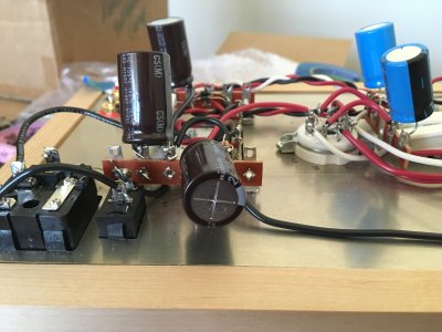

Hi guys,
When I turn the crack on nothing happens...I'm new at this whole thing and even though I have a multimeter, I don't really know how to use it/scared after reading the warning that I might shock myself (sad I know).
Any tips/suggestions would be really appreciated! I know my soldering skills are not the best, I've made a switchbox and an aux cable to practice but that is the extent of my experience with soldering.

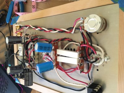

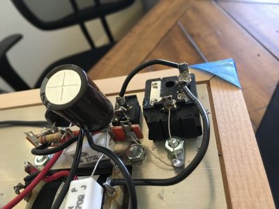

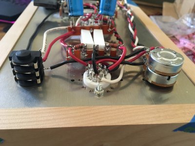

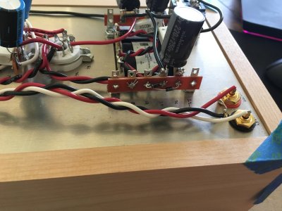

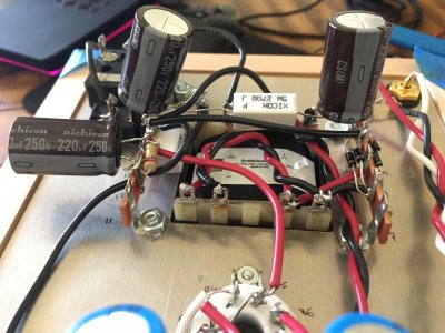

Here are several problems visible in your pictures:
1) You have incorrectly mounted your transformer.
2) You have used the wrong screw lengths on your 9-pin socket.
3) You have used the wrong screw lengths on your octal socket.
4) You have a backwards diode in your power supply.
5) You have incorrectly mounted the black RCA jack (and most likely the red as well).

Also real quick...can you please point out to me the where the backwards diode on the power supply is?

#18 -> #21

    • Posts: 20304
Reply #5 on: August 26, 2016, 08:04:01 AM
On the red wire that goes to A4/A5, you have a lot of bare wire exposed.  If this exposed wire touches A6, you will damage some components in the amplifier.
