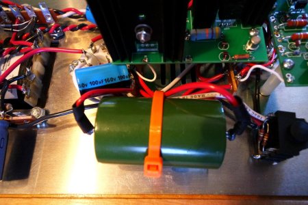

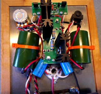

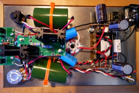

Offline joej
    • Posts: 5
Reply #5 on: September 17, 2016, 11:04:57 AM
Easy mod. I haven't made any permanent changes with mounting brackets in case I prefer going back to the stock Crack/Speedball. With 100 hours of burn in I will reserve judgment. There is a noticeable change in sound. I do like the stock crack/speedball, so time will tell if this is an improvement or not. Less expensive experiment than rolling more expensive tubes. Plenty of room for two Russian k75-10s.
