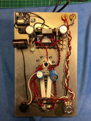

Last night I posted a thread that I had some issues with my resistance readings. I fixed a jumper that I was missing and a bad solder joint and then everything seemed to work. Today, I rechecked the resistance readings before continuing the the voltage check and I got the same errors that seemed to be fixed last night plus some new ones.
Also to note: I painted my transformer bell cover with ceramic enamel paint. Not sure if that affects grounding which might make my resistance measurements off. I also did the revision on page 19 of the Crack manual which connects the 3" black wire to Terminal 14U instead of 22L for quieter operation.
Here are my readings the issues are Terminals 2,4, 14, 20 and the right RCA ground lug. (sorry about the shitty formatting, can't seem to fix it):

Terminals 2 and 4 are connected by a piece of wire.  If the piece of wire is there and well soldered, they cannot have a different resistance reading.  If they do indeed have such a wildly different resistance reading, then the piece of wire is not well connected.  (recheck, and look for a "K" or an "M" on your meter to indicate thousands or millions of Ohms)
There's supposed to be a jumper from 12 to 14.  I don't see it in your photo.

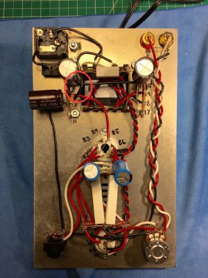

Thanks for your reply, I checked Terminals 2 and 4 again and they did end up having the same resistance reading. My meter is not very consistent so they fluctuate between 0.2K and 0.3K ohms. The jumper from 12 to 14 is there, the photo is a little deceiving and it looks like its part of the one above it. See the annotated photo below.
