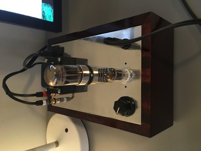

I'm sure this is a pretty stupid question but I couldn't find anything via the search, how am I supposed to install both of the tubes into the sockets? I got the pins to line up but the tubes won't press in all the way and I'm afraid to force it since its resisting so much.

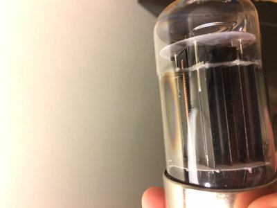

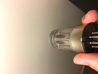

I've got another question. After a few days of listening my driver tube is getting some burn marks as visible in the 2 photos. Being new to tubes I'm not sure if this is normal or if my tubes are running too hot?
Reply #9 on: September 09, 2016, 04:49:27 AM
It's perfectly normal.
