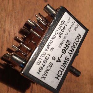

Does anyone have experience with replacements for the stock bee pre input selector switch? I am just building a bee pre and ordered it with the bee quiet upgrade and to be somehow consitent I'd like to replace the stock input selector switch as well. I got a TKD input selector switch I didn't use in a former project - see pic - I think this one should be okay. Does anyone have experience with this or other options? Thanx a lot, Chris

You'll have to drill several extra holes in the attenuator overlay that comes with the Beequiet to use that TKD selector switch.  It also will not provide ground switching like the stock switch will.  You'd also want to be very, very sure that it isn't too large to interfere with the Beequiet.

Reply #2 on: October 13, 2016, 02:07:02 PM
Thank you Paul - I just realized again that I really have to learn a lot about audio circuits...
Talking about the ground switching the stock switch provides - What exactly does this mean or what ecactly is the difference between the two switches?
Still I would like to try another input switch as the stock one - but with aequivalent switching options like the stock switch. What type of switch do I exactly have to look for?

Reply #4 on: July 01, 2017, 03:00:28 AM
Hi Paul,
thank you for your answer regarding the Tubes working with the BeePre. In the meantime Imfigured out about the input selector switch and got myself a TKD 4R6 that should do the trick with ground switching as it has 4 instead of only 2 switching levels.

Regarding the replacement of the stock selector switch I am totally aware of the points you mentionned regarding drilling additional holes for the TKD and the size of that TKD switch. In the meantime I even got a bigger one as you raised the ground switching issue I would run into when usimg a 2R6 I got a 4R6 that solves that issue.
I am just about to figure out how to wire it properly.

- Regarding TKD 4R6: To have proper ground switching I guess that I can use one of the additional 2 switching layers (4R6 offers 4 instead of 2 the of the 2R6) or am I thinking in a wrong direction? Oversee something?

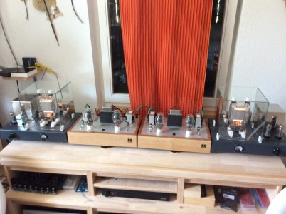

ps: attached a pic of the power amp section of my system - now there are 3 Kaijus and I am planning to get two more and to set them up as monoblocks for the Klipschorns - that raises the next question I have to bother you with soon regarding the the international availability of the Bottlehead speaker kit....
