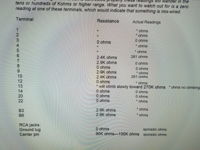

Reply #3 on: September 12, 2016, 05:31:14 PM
Yes it is a stock built crack and speedball. I did the resistance checks and got very strange results. Here they are below.

Reply #4 on: September 12, 2016, 06:13:24 PM
A stock Crack build DOES NOT have a Speedball.
Your first step is to remove the Speedball and install the resistors.
Then repeat the resistance checks.
DO NOT plug in your Crack without passing resistance checks. The instructions are quite clear about this.
