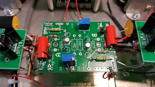

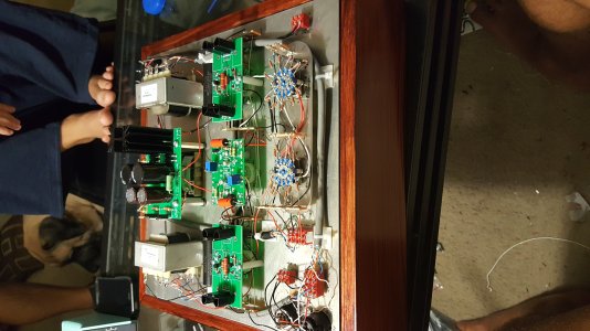

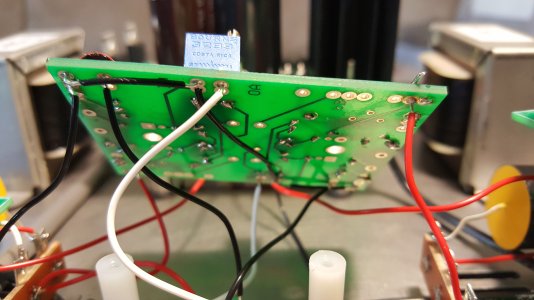

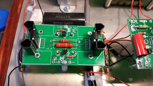

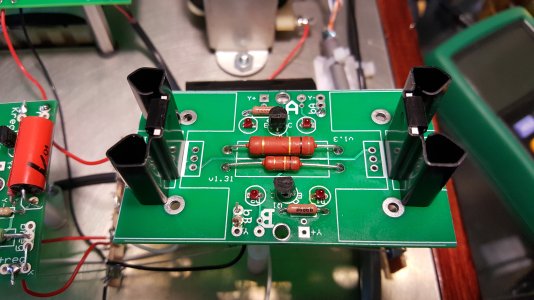

Reply #5 on: October 25, 2016, 01:25:35 PM
Swapped the tubes. issue did not follow stil un adjustable voltage at C side cap at 30.
See attached pictures

Reply #6 on: October 25, 2016, 02:11:35 PM
+275vDC on power Supply: 267.9
+6.3vDC on Power Supply: 6.30
IA on A side C4S: 269.1
IA on C side C4S: 269.2
Breg(both sides: 219.3/220.6
-reg(both sides): 0/0
Kreg(both sides): 11.11/10.74
OA on center board: 3.37
OB on center board: 2.02
IA/IB centerboard: 0
A side vs C side measurements: A/C
IB: 219.3/220.6
IA: 270.1/270.1
OB: 139.9/205.9
OA: 219.2/220.6
smaal res: 216.2/217.6
big res: 264.3/264.2
also the 2 37/49 small rez match up in voltage. Only noticable difference is in OB between the A/C side
Offline anteroth
    • Posts: 6
Reply #7 on: October 25, 2016, 02:23:33 PM
So turns out if the trim pot is driven all the way up it behaves oddly at that end of the range. I tried turningthe working pot all the way up to see how it bhecaed(all the way up mechanically not electicaly) it behaved the same way. So i drove both pots all the way in and both went to approx 80v the low end of trim. then adjsuted both back up to 145. For anyone getting odd response try turning it until its all the way out then all the way in. if it goes down to 80 v that was your problem and just adjust up to 145. your trim pot was too far out and behaving strangely.
