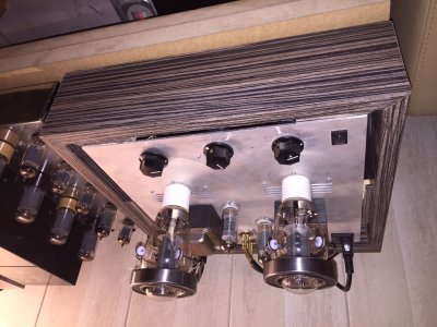

I did remake the base using a nice zebrano wood, and I left a few millimeters between the baseplate and the sides. This, I think, has the double benefit of airflow to improve cooling the underside, and isolating the microphonics by having the baseplate rest on silicone mats fixed on the sides.
looks and sounds good !!
