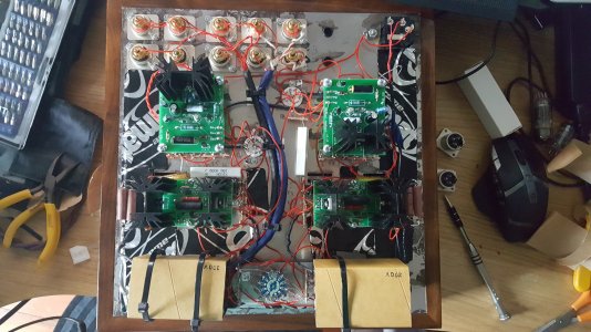

I have finished my stock build but I have a couple of weird voltages: D1 has 0.06V and 37 has -0.05.I also measured by mistake D4,D5,D6,D7 with 6.55 but I saw after it's N/A. I also have a slight channel imbalance but also slightly less  voltage on one side for example 10 is 180.1 and 15 is 182.1 but withing the margin of error.
Even so it sounds great and I have to admit better that I expected, the 300B are exactly what I was looking for. I will give a few days to make sure it's stable and then install the BeQuiet, jupiters and elrog.
Could I replace the XLR output with another RCA? Is it as easy as removing the caps and linking the the positive and negative with the existing RCA output? I would like to output to two amps at the same time.

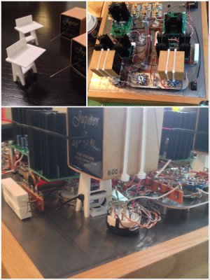

I swapped the 10uF coupling caps to a Jupiter HT Flat Stacked 3.3uF, and I had a mounting bracket 3D printed to hold the cap over the BeeQuiet.  I've been meaning to offer up the model file to the community, but have been too busy listening ;D  See the attached file for an idea of my solution.
Yes, you can, and it is exactly that simple!  I did this in my build - works like a charm.  Wanted a balanced input rather than a balanced output (I biamp, but my downstream amps are both single-ended).  I followed the guide for the balanced inputs, except used the included jacks.  Still looking for input transformers, so that input isn't usable yet, but both outputs work great.
