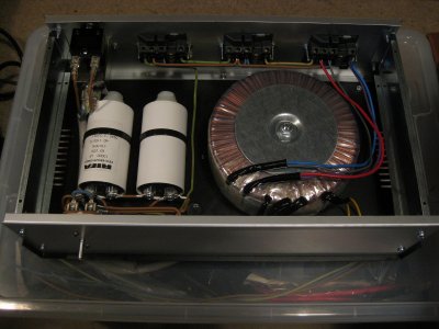

A mains filter and isolation transformer should get you there.
No need to spend big money as i picked up a Belkin PF-60 mains filter for £100 on eBay which all my gear is fed from.  The isolation transformer was another bargain i found on eBay for £30, its a 1KVA toroid with x2 120v windings so i have it setup as a balanced 240v output to feed my speaker amps and preamps. Whole setup probably cost me £200.

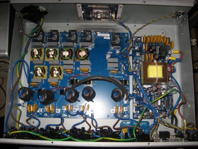

mcandmar -  did you chop up those units to build a home brew box, or are the photos the commercial units?
Finally, anyone have any luck building a single homemade unit?
The PureAV is a commercial unit, the isolation transformer unit i built myself.  I did have my own DIY filter box but i dismantled it when i bought the PureAV as its a much better unit.

Consider me a complete and total newbie in all things - any chance you could assist with the layout and parts list for the isolation transformer setup?  Not clear on what a "wingding" is!
