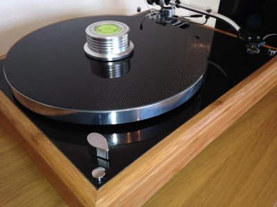

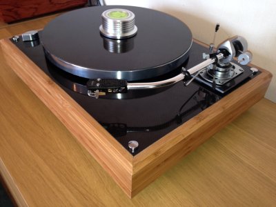

I picked up an old beat up Thorens TD160 a while back with the intention of making it a bit of a project. Its been sat on the shelf in the garage since but during a bit of net surfing on some turntable stuff last week I stumbled across the BooPlinth which is a Bamboo aftermarket plinth for the Linn Sondek LP12 with a whopping £1,950 price tag!  http://www.booplinth.com/
My pockets are not that deep but it did spark my imagination and after a quick measure up of the TD160 I found a new use for a Ikea Bamboo chopping board (I picked a few extra up on my last visit to the store). I finished putting it all back together yesterday and hooked up to the Eros ;D
I'm pretty chuffed with how this one has turned out.

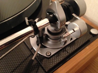

Wow!!! That is just stunning. The carbon fiber looks awesome. But that's not just any TD-160. You've got an SME tonearm. What cartridge are you using?
Btw, do you know this site; www.vinylnirvana.com
Alan
Hi Alan
I'm using a vintage A&R P77 cart with a Jico SAS stylus. I recently picked up a Shure V15 mark III which should arrive this week luckily both the P77 and Shure can use the same Jico SAS stylus  ;)

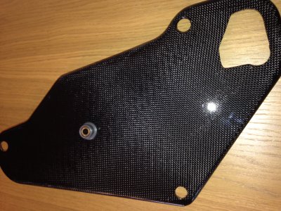

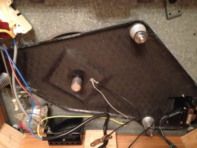

Offline JamieMcC
    • Posts: 1171
Reply #7 on: November 27, 2016, 02:38:06 AM
Finished making and installing my other LP12 inspired mod yesterday a carbon fibre subframe  ::) Sounds good so far. Its a about half a kilo lighter than the metal one and is more ridged. Next step is to try adding that half a kilo of mass back into the underside of the flywheel.
