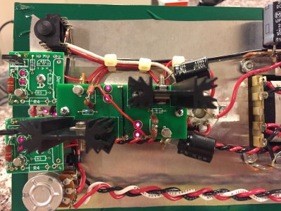

When I installed the Large board and turned it on, he two LEDs on the "B+" side of the board were glowing normally, but on the "G" Side of the board, the one closest to the center is dark and the one on the outside is REALLY bright.  I also heard a low hum in the background (my crack has always been whisper-silent.
Measurements on Large Board:
OA= 91.6V Expected=60-90v
OB= 7147.8V  Expected=60-90V
B+= 171V (OK) Expected170-195V
G = 0V (OK) Expected=0V

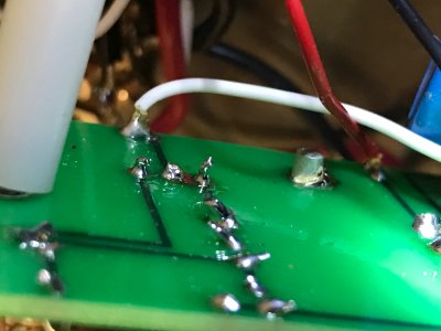

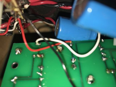

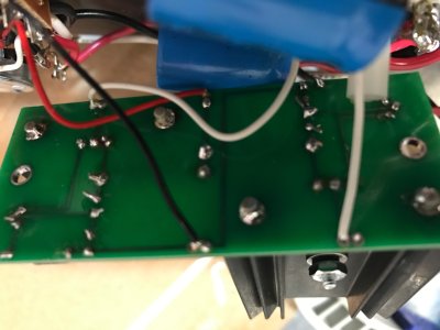

After I measured the voltage, I checked the soldering (everything looked good), and tried to power the crack again, but it will not power on.  I noticed a red mark on the board at Q2A (see picture on top).  Thoughts?  Did I fry my Crack?  I checked resistance on OB and OA, and they were both over 100 Ohms.

Can you post a clearer photo of the bottom of the PCB?  It looks like there might be a solder bridge between two pads, but it's hard to say.

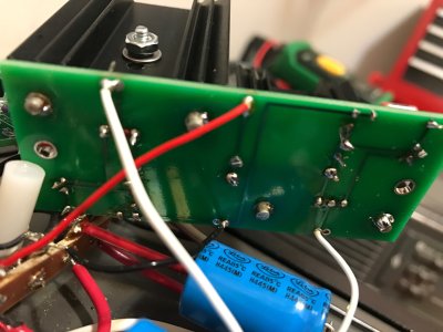

On the bottom of the big PCB, you need to trim the leads of those components back considerably, then I would recommend reheating all the joints on the board.  It looks like two pins of one of the 2N2222 transistors may be touching each other.

Paul - you were right, and all voltages measure correctly and the Crack sounds great!  How do I do about buying you a virtual beer?
