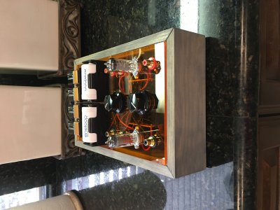

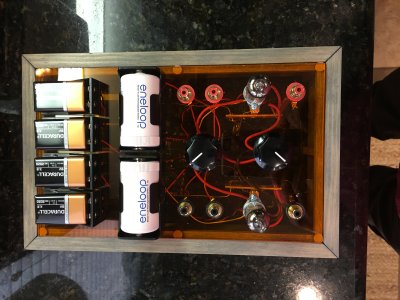

I thought I would add a couple of pictures showing the transparent top plate.
Brad Nalitt

Reply #3 on: December 29, 2016, 10:54:43 AM
Love the clear chassis plate.  The quickie is one of my favorites, makes a cracking little headphone amp too :)
Offline JamieMcC
    • Posts: 1171
Reply #4 on: December 29, 2016, 10:22:14 PM
Nice I like the transparent top  8)
