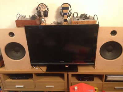

Offline JamieMcC
    • Posts: 1171
Reply #3 on: January 10, 2017, 10:40:05 AM
Hi Michael

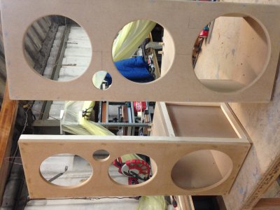

I ended up going with the Vifa h26tg35-06 tweeter this was recommended by someone who has the same driver and Vifa OB set up they have also been very helpful sharing their crossover info and have made some temporary mdf baffles up to get started with. I fired them up for the first time today using my 2W Sex amp and have been trying out some different crossover configurations this afternoon (just by ear). I know its early days configuring and positioning wise and I've still to get my active sub up and running but even so they have already impressed the hell out of me and I'm really looking forward to experimenting and getting them better dialled in.

Nice. They look great. I'm sure they sound great.

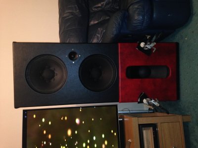

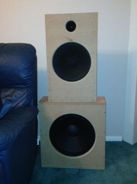

Reply #6 on: October 26, 2017, 06:43:49 AM
Little up date
A while back I added a pair of 15" Eminence Alph15A subs these are crossed at 200 Hz its fair to say the sound is off the scale the bastanis 12" drivers are just insanely good. The only real issue is they are just to big for my room so I'm thinking with a heavy heart about final enclosures and maybe down sizing to a from the 15" bass driver to a 12" to make them a little easier to live with.
Trying out some different configurations

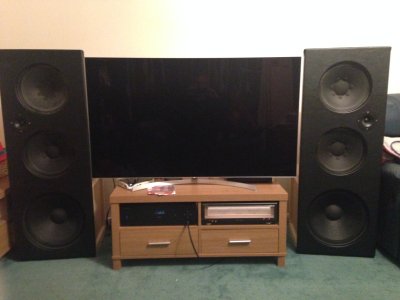

Reply #7 on: January 20, 2019, 05:42:10 AM
Up she rises for little update

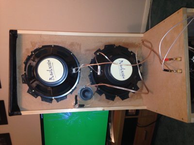

I've had a lot of fun and learnt a bit experimenting with these speakers over the last couple of years. Recently I had the chance to pick up another pair of Bastanis Mandala 12" crystal drivers again which meant a bit of a reconfiguration was require one sheet of 19mm (three quarter inch) mdf and a metre (three and a bit feet) of leatherette added to keep the wife happy and I'm up and running again.
At 100dbish while they sound reasonably ok using just my Sex the sonics noticably improve if I just use the Sex to drive the top half and a seperate amp the 15" bass. Plenty of fun tweeking still to come I think.

I have really enjoyed the single Mandala driver baffle over the last two years its had a number of crossover configurations during that time. But having two Mandala drivers has brought a nice improvement. Still have a few amps in the house to try with them at some point.
