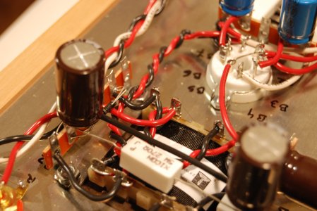

With this many incorrect readings, the most common culprit is an un-/mis-wired ground connection. Can you post pictures of your build?
Joshua Harris
Kit Packer Emeritus
    • Posts: 20297
Reply #2 on: January 05, 2017, 01:33:45 PM
3     0       13.4M (first read) / 4.6M (second read)
This indicates that the buss of black wires through the amp is not properly connected and/or soldered.  Follow it from the unbanded ends of the UF4007 diodes as it crosses the power transformer, up to the headphone jack, then to T3.  I bet the solder joint on your headphone jack where the black wires meed is not all the way soldered, and one wire is loose or has popped out.
RCA
Center   Red = 106K; Black = 4.6M
This would tend to indicate that the jumper between the grounds on the volume pot isn't present.
Josh is correct, some photos would help a lot.

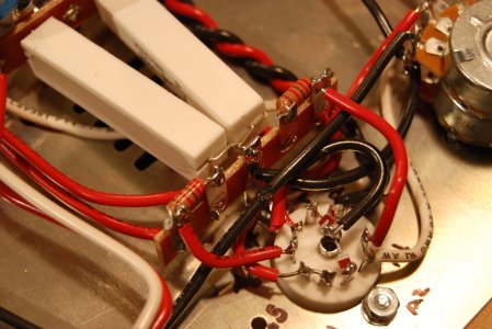

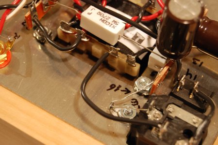

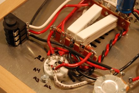

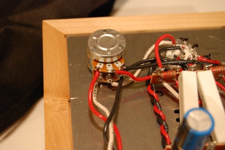

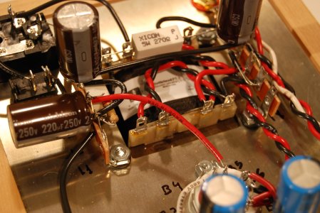

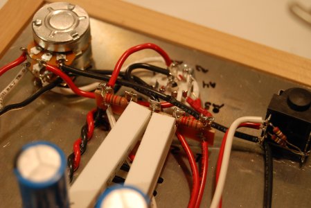

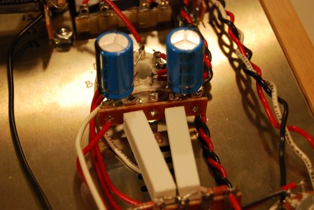

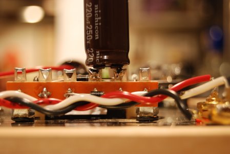

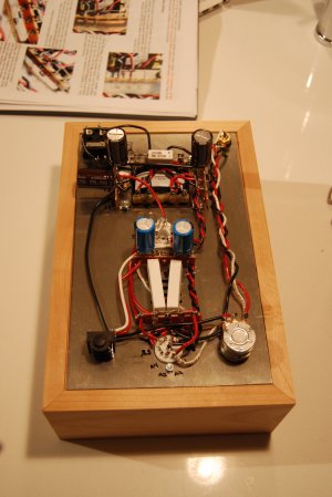

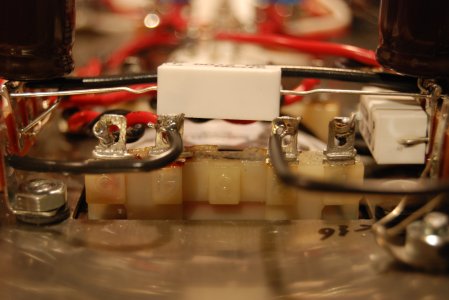

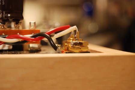

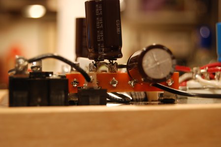

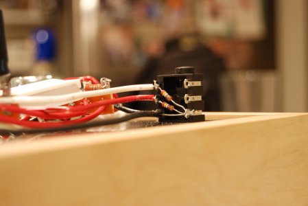

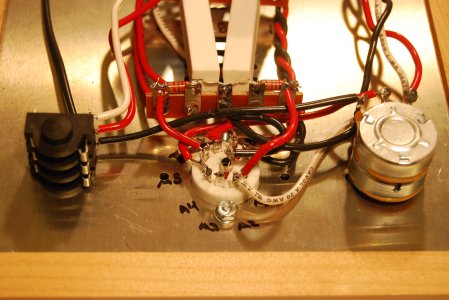

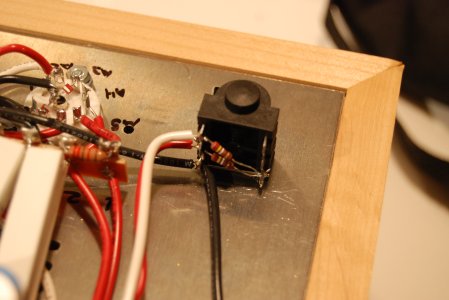

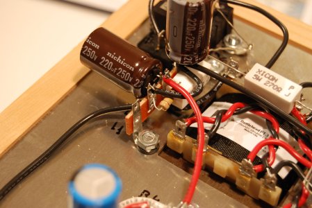

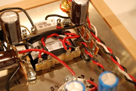

Sorry, I had to retake the pics once I found the camera's tripod. I tried to get as many angles as I thought were useful, but let me know if you want another take. I followed the paths of black wire and they were all solidly joined (cold maybe?).
Some notes: T15 was tough. As I finished soldering the whole thing moved, so I had to reapply. Also, I accidentally applied too much solder on the black RCA and it dripped. I tried to get as much out with solder wick as I could, but that thing never worked properly. I can assure that the solder is not "joining" anything it shouldn't here. Finally, I accidentally burned some cables with the iron. No exposed wire though.
Finally, I am curious about 2 parts that were not called by the manual: some kind of glass tube with 2 aluminum ends. One side has F1.5AL250V engraved on it. The other is a star lock washer. I know I double and triple checked everything, it's just that they were never called during assembly.
Thanks for your help!

    • Posts: 20297
Reply #8 on: January 06, 2017, 08:39:14 AM
Please do check into these issues, they still seem likely after examining your photos.
Offline Kakuz
    • Posts: 5
Reply #9 on: January 06, 2017, 01:57:16 PM
You are great, that did it. I had probed each black wire connection earlier, but I just applied some heat and solder to the jack and T12 and now everything is fine! some measurements are off by a bit (2.48k instead of 2.4k, or 2.98k instead of 2.9k) but that seems like the expected variation.
Thanks a lot, now onto voltage!
