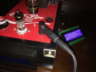

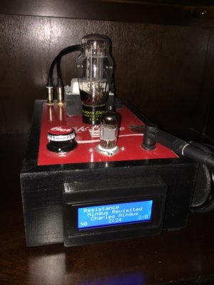

The day I built this Crack i knew I wanted an integrated Raspberry Pi, hence the name CrackPipe.  I actually did it with another but never incorporated an LCD which was also part of the plan from day one.  There just wasn't enough real estate to mount it flush from inside really and I didn't have those tools anyway.
I 3D Printed a 20x4 LCD bezel and right now the pi is just laying down under it with a USB DAC HiFiMe 9018.
I only had 6" female to female breadboard wires and Mr. Amazon is bringing me 12" cables tomorrow so I'll be able to mount the pi on the side and make it nice and tidy.
Pi has logitechmediaserver on it with a python script somebody else wrote to fetch track data and such.
Also I need to touch up the case and snug the LCD a little tighter but it all has to come apart one more time.

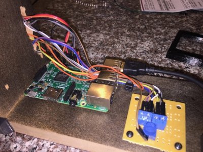

Reply #1 on: January 15, 2017, 10:24:40 AM
This is kind of what the mounting will look like.  Will get some stand offs in here as well.  Also on the way from Mr. Amazon.

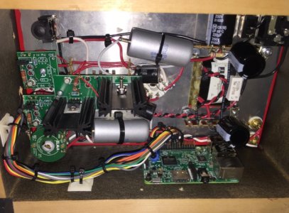

Reply #6 on: January 19, 2017, 12:20:08 AM
Still need to do some clean up work.  Considering pushing the Pi against the back wall and cutting out a square for the USB and Ethernet.  Also the big Russian hacking capacitor kept falling down.  Need a new sticky stand off for it.  But this is the jest of how it turned out.  I can move the pi down a bit too if I get a right angle mini-usb connector.   Absolutely no noise in the music circuit from the amp.
I can confirm wiring the LCD in 8 bit mode stops the data corruption during power up and power down.  Only downside is there is now 12 wires instead of 8.  Not a big difference.
All in all this is about how I imagined it all those years ago.  Now my amp is truly CrackPipe.

Reply #10 on: January 29, 2017, 11:31:35 PM
Whew, that's a lot of wiring in a tight space!
Barely fits. And I just got a 90 degree angle power cord for the Pi.  I can slide it down the wall almost to the ground now.  Just haven't gotten around to doing it.  Works great, looks cool.  Almost scared to pick it up and move it again.
