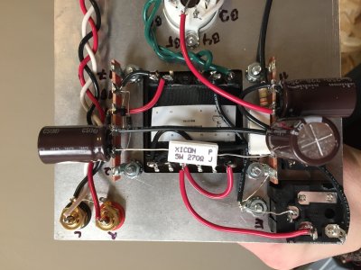

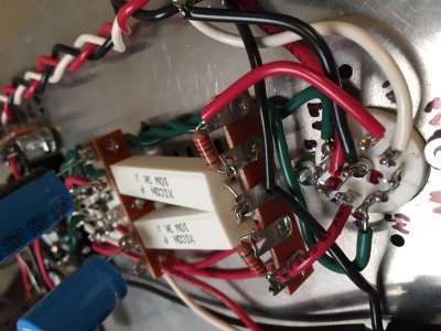

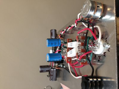

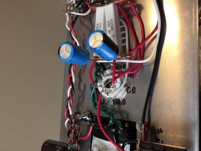

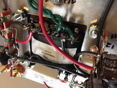

Hey everyone,

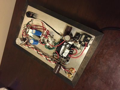

     I know this has come up before and seems like the consensus is that it's a grounding issue, but I have probed around and my grounding seems to be fine.  I'm uploading some pictures if someone can spot something I'm missing.  Any help is appreciated.  Thanks!

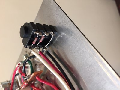

    • Posts: 20296
Reply #7 on: January 22, 2017, 09:36:49 AM
The juncture of the black wires on the headphone jack is not properly soldered (see in the photo how one wire is just floating in the middle of the terminal).
Offline mfryan
    • Posts: 11
  • Malo mori quam foedari
Reply #8 on: January 22, 2017, 11:46:28 AM
Thank you Caucasian Blackplate!!!  I look it over time and again and did not catch that...  That solved it.  Now it's quiet and the sound is incredibly good!  Thanks a million!
