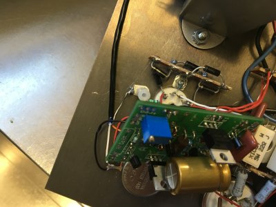

I built the new board,installed it and had the same results...burned board. Here is an image of the Zener diodes, all correctly oriented.
Any thoughts?
Reply #8 on: February 16, 2017, 08:29:56 AM
Did you replace the zeners? By your description that was your root problem.

Reply #10 on: February 16, 2017, 10:53:53 AM
You said earlier in the thread that the the zeners were correctly oriented but that they also fried. Then you found that one was shorted to another terminal. I would say, yes, based upon that info the zeners should have been replaced when the board was replaced. The high voltage indicates that the zener string is now open and not regulating. You should replace those zener diodes before you power up the amp again.

Reply #12 on: February 19, 2017, 12:48:26 PM
In your photo, it looks like a lead from one of the zeners is untrimmed and resting against the chassis plate.
Replacing the zener diodes is absolutely a mandatory part of repairing the issue you had. This was something that would come up from time to time with Paramounts, so we've been down this road before.  Not replacing the zeners may just lead to new boards blowing up repeatedly.  I even took the steps of contacting the folks at replacement parts to be sure that the zener diodes were included in the package.
