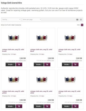

Will I be able to use these wires? I would be going for the 22 AWG. They are solid copper and rated for 600V,
"Vintage Cloth Covered Wire
Authentic reproduction double-cloth jacketed wire. 22 (US) / 0,65 mm dia. gauge solid copper 600V rated. Great for repairing vintage gear, rewireing guitars, but you can use it on new & homebrew projects as well."

First of all I'm not trying to talk you out of using that wire. But I'm curious why it's an upgrade. There is no mention of the purity of the copper in the description so I bet the wire supplied in the kit is comparable.  That leaves the cloth insulator as the difference. So my question is what makes cloth insulated wire an upgrade over PTFE or any other modern insulator?
