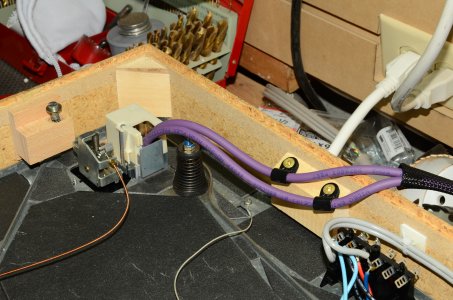

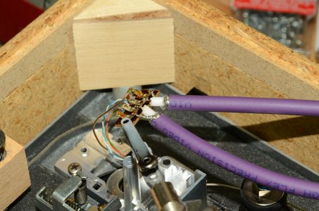

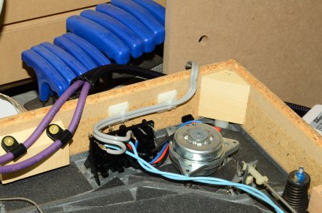

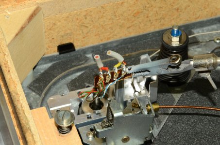

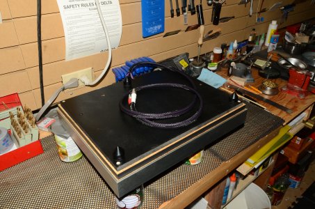

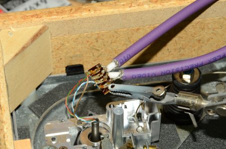

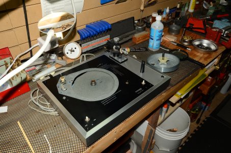

 Having read much about the Chadwick mods for Thorens turntables I have decided to apply some of the more popular ones to my deck. The initial inspection shows the spindle and bearing well to be in excellent condition after all these years of service.  I have removed the foam from the springs and added sheets of SoundCoat to deaden vibrations on the motor board.
 A new phono cable replaces the original, made from Belden 1505F. A half inch mdf bottom panel will replace the 1/8 in thick unit originally installed. A set of spiked feet will provide further isolation.
I'm looking forward to auditioning the results, attached are some photos of th project so far.

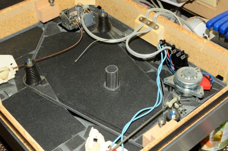

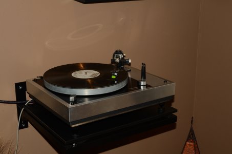

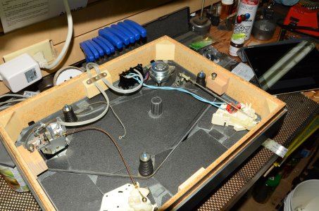

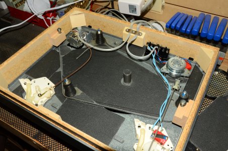

Here are a couple more photos of the project so far. These mods have made a definite improvement to the deck. I'm waiting for the platter isolation and spindle kits to arrive (thanks for the information Don). Once all this is installed I'll listen for a while and then install my Funk Firm Achromat and report my impressions.

It is looking good, Is that bottom plate made out of Star Board? You might want to listen to for a while and then take off the bottom plate and listen.

The bottom board is 1/2" mdf. I will try it without the bottom board when I build the new plinth, I'll construct it so a bottom board can be readily added or removed. The platter isolation and spindle bearing/oil kit arrived yesterday. It will likely be the weekend before I have time to install them. I look forward to auditioning the upgrades.
I'm not yet in a position to do an arm upgrade...the bearings seem to be well adjusted on the stock arm, there is no lash in the tonearm. I've read conflicting reports as to the merits of rewiring the arm. I don't know if it's worth the effort...would simply cleaning the cart pins with DeOxit do just as well?
