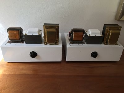

This weekend I took out whatever was left of the Parabees. Mostly gone except for the power supplies. Decided on how to rebuild using only tubes, iron and main parts on hand. The amps will be 2w 300Bs with dowdy chokes and tl404s. Alps pot in the front. All white to be used in my office (picked a pair of the cheap BS 22 Pioneer soeakers which are so far very promising). Driver stage is a c4sd 5965. Direct coupled. DC filaments using PJs old recipee. The paint job leaves a lot to be desired as I only left the painting curate a couple of hours. I had forgotten how nice the pgp 8.1s are.
