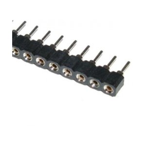

In my phono stage, I added two sockets that would let me play around with some changes.  Do an EBay search on "Break Away Female Headers - Swiss Machine Pin" and you'll find plenty.  Just snap off what you need, solder it down into the PCB and you insert the resistor or capacitor legs into the socket.  It is an easy way to experiment with different values on a PCB without having to futz around too much.  They grip quite tightly to the legs of various devices.

Thank you Eric. I ordered the break away female headers, now if I can figure out if 10 ohms is the correct loading for my MC20MKII, I'll get some resistors on order, and start rolling them through.
