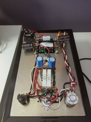

One question though... I did screw up the position of the 220uf caps. They're in the right terminals... just the two aren't vertical. Does this seem like it would cause any issues in the future?

I am still getting the strange noise/scratchiness when I initially turn the amp on and plug-in after about 3-5 minutes (even when volume is turned all the way down). I thought it was interference from various power cords... the Crack is positioned about 4 feet from everything that I can think would cause noise and the power cord is on its own receptacle now.
After being on and playing music for about 10 minutes the noise/scratchiness goes away. Is this typical for a bad solder joint?

Yes, you may have an iffy solder joint.
If the caps are on the correct terminals, but laid against the chassis, this isn't a problem.

Reflowed the solder joints but now there are extremely loud pops when plugging in the TRS jack as it passes each ring. Any ideas? I noticed another post mentioned the ground path.

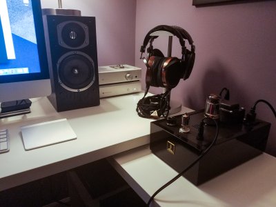

Nice job!  I really like the treatments you did on your exteriors.   What color/paint did you use for your top plate?  What stain is that for your base?

Thanks! I used Rust-Oleum Hammered black spray paint (it ends up being a dark gray) on the chassis and the transformer bell plate. They both got about 8 thin coats.
I used Minwax Mission Oak Polyshades. I'd probably recommend something else though. 2 coats was a nice color but it was uneven. The third coat got really, really dark but evened out. After researching more - I'm picking up some dark mahogany aniline dye for my Reduction.

Chopsticks test success. Loose ground wire from terminal 3 to headphone jack.
Reflowed and silent as can be.
