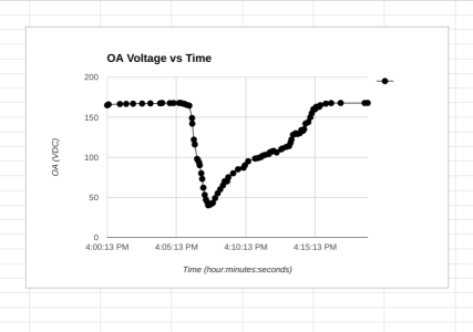

I was hoping to get all the measurements done and plotted in one posting, but this is going to take longer than I thought (really should grab a DAQ from work...) I have not replaced the 12BH7, as I don't have another one yet.
Here's right-channel OA (VDC) versus time. Summary: At about six minutes after powering on, the voltage drops from 167 VDC to a minimum of about 40 VDC. Then the reading climbs (not linearly), getting back up over 167 VDC about 16 minutes after powering on, and then being stable (I got tired of measuring after 3 minutes of steady-state.) (Note: I'll probably change the time axis to read minutes once I get all measurements done, and put this on a different spreadsheet program so I can fix all the things about this graph I don't like, but that'll have to wait until I have less work to do hahaha.)

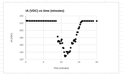

IA (VDC) was 226 VDC. Pretty much only fluctuated about 0.1 VDC. I measured over a period of 10 minutes from powering on.
So: Summary: OA had a transient from 167 VDC down to 40 VDC that occurred about 6 minutes after powering on. OA then rose non-linearly back to 167 VDC over the next 10 minutes of operation, then seemed stable.
OB was ~97 VDC over 20 minutes of operation.
IA was 226 VDC.
