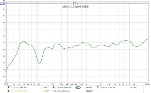

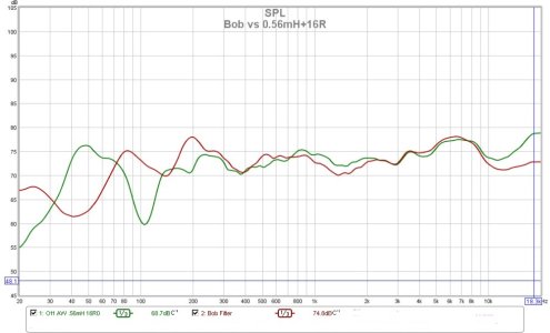

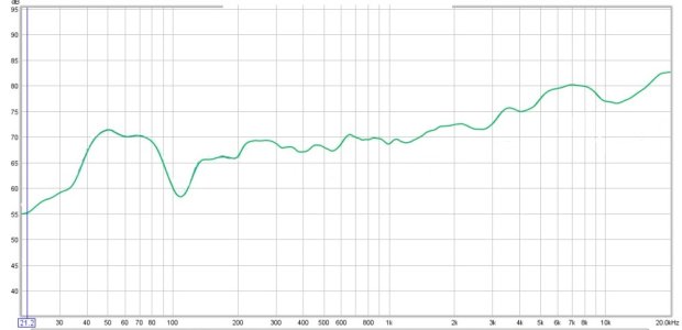

I've attached some images, all are measured frequency response of my 1772's in a 40L ported box that is up against the wall in a small room (12ft by 14ft).  The first image is the raw response of the driver/box combination with no crossover.  The second shows a comparison between my crossover (0.56mH inductor in parallel with a 15R resistor) and the crossover that Bob Brines designed for this speaker.  The primary difference is the correction Bob adds to the 10kHz+ region. I happen to like the slight rise in response at the treble end and my network is more simple.  If you want to bring the treble response down a bit more, change 15R to 20R (see last image).  Measurements were taken on-axis about 4 feet away from the speaker and the graphs show 1/3 octave smoothing (cleans up the jaggies a little).  If you move off axis, treble response diminishes a bit (like most other speakers).  I wouldn't read too much into the the big peak and dip below 200Hz - these are likely due to the physical configuration of the room.  Also, don't go comparing absolute dB level output across graphs as these were made at different points in time with different volume levels.  The point is to compare the general shape of the response plots.

The L-Pad approach is a great way to experiment with the treble level.  I built mine this way, listened for a few days, made minor adjustments, listened some more, adjusted some more...  They produce plenty of bass, and if you're a purist, you'll probably be fine with these speakers on their own.  I like a bit of kick from my bass, so I run these with my DIY sub.
