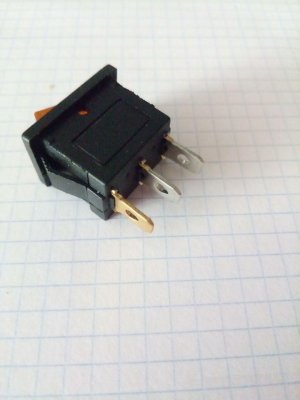

Offline mr_jimmybob
    • Posts: 5
Reply #11 on: August 16, 2018, 04:01:07 AM
Hi again.
Here is some more information on what I have.
This is what I have bought and installed on my Crack 1.1:
https://www.ebay.com/itm/9-Pcs-Yellow-3Pin-2Position-ON-OFF-SPST-With-lamp-Rocker-Switch-6A-250V-10A-125V/162211373361?ssPageName=STRK%3AMEBIDX%3AIT&_trksid=p2060353.m2749.l2649
Good thing is that it fits perfectly in the Crack, but no details on how to wire it are given.
I have found wiring instructions on youtube, but they only cover how to conect it to DC (see here )
I will post my findings if any here for the benefit of others.

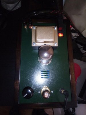

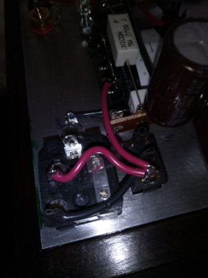

Offline mr_jimmybob
    • Posts: 5

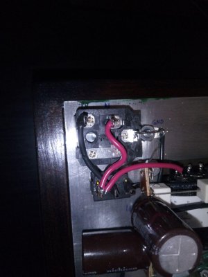

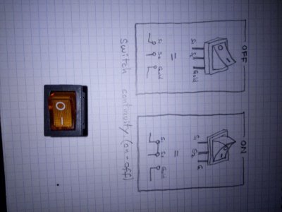

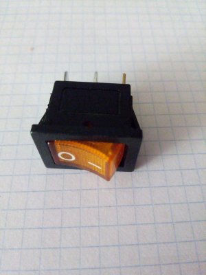

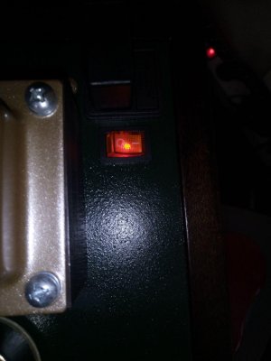

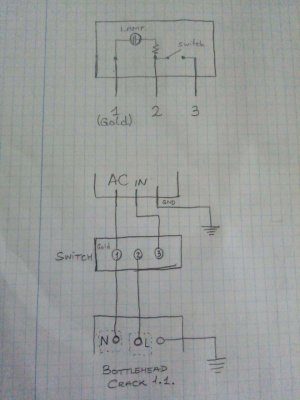

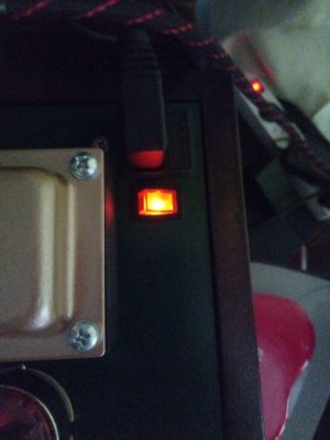

Reply #13 on: September 03, 2018, 08:32:30 AM
I have found a new video here : that explains the connections for AC.
I have followed the instructions and now have a funky illuminated rocker switch that actually lights up when turned on... not like before.
In retrospect, as Doc said, I find it kind of redundant and useless right now, but anyhoo.
I have attached some photos to try and help others do the same.
If you need any other information or help please let me know.
Have fun.
