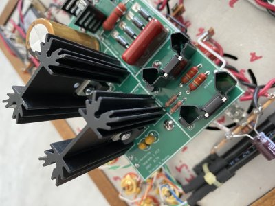

Strep throat is gone, so I am looking at the Moreplay again. As I was just about to redo the solder joints to rectify the fade to distortion I noticed one of the smaller brown capacitors has the beginnings of a bulge. While I doubt that relates to the fading, is that something I should replace asap? If I do I assume I should have to matching ones?

Offline Thermioniclife
    • Posts: 815
Reply #4 on: June 19, 2025, 09:13:34 AM
Yeah I Would replace and double check for proper polarity.

    • Posts: 9790
Reply #6 on: June 19, 2025, 01:07:19 PM
You also have a film cap that has a blob of solder on it. If that has melted thru the outer plastic coating you could have a shorted cap. If it just pops off and the plastic underneath looks OK it is fine.
    • Posts: 20297
Reply #7 on: June 19, 2025, 03:28:31 PM
Once you have completed replacing that cap, please check the DC voltage at the junction between those two caps and report it here.  It is extremely rare for this kind of failure to occur, and it's possible that one of the 270K balancing resistors isn't well connected, which is causing too much voltage to appear across that cap.

Reply #8 on: July 02, 2025, 06:16:55 AM
Okay,
I am sorry that this took me so long to fix, but my soldering iron melted down mid-repair...and that may have solved the problem: my Hakko soldering iron feels like it may have been a "fake", and after 12 years of service it slowly had died a bad death.  Anyway, I found a replacement for $17 on Amazon (probably also fake), but it now suddenly works and took away all cold solder looks that I was getting on the joints. It is like night and day, so I redid everything and presto-chango - it all works again.
I expect that this is what caused the capacitor to begin its bulge.I found that once I resoldered everything it was visually clear that the iron had not heated connections well at all. So I expect Paul was right that there was something wrong leading into the capacitor.   I am going to put the Moreplay back into the system and let it run for a bit before vacation. When I come back I will replace the two capacitors and see. Then I will do the upgrade and probably be back in the forum with tears - ha ha ha.
