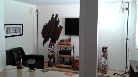

So we knocked out half of the walk-in closet, Green Glued up a second layer of drywall and turned one of the upstairs bedrooms into a beer-bar/den.
The popcorn ceiling is gone and now the TV is virtually unintelligible (as if that isn't already part of the description) Music is not so bad, I'm guessing because the speakers are lower.
If anyone has ideas short of re-spraying the ceiling, they would be greatly appreciated. (Bonus points for high WAF!)

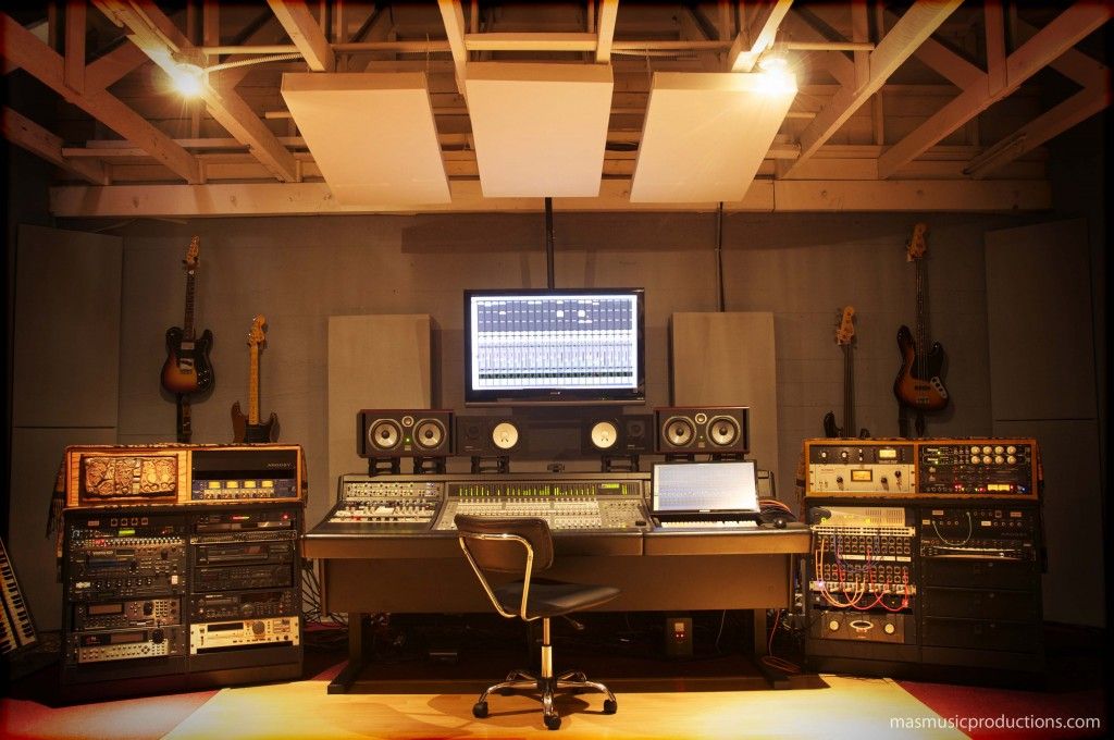

Reply #4 on: June 01, 2017, 01:27:03 PM
That could work. Or something along these lines -
(https://s-media-cache-ak0.pinimg.com/originals/d8/88/bd/d888bdb37b4a76d0ff01d0365933cb35.jpg)

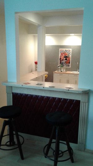

I was pleasantly surprised how much installing the diamond tuck-n-roll bar kick panel (about 20% of back wall) did. I also expanded the recycled wood mosaic (seen to the left of the TV in the original post) to approx. 70% of the front wall to act as a diffuser.
