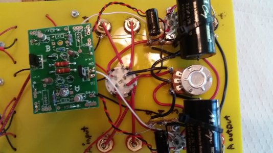

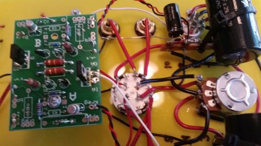

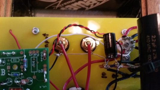

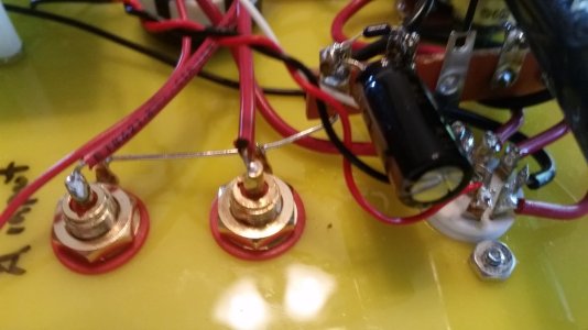

I have been using the quickie for several months now and up until now it has been working great. Yesterday it started to have some issues. I have a cd player plugged into the inputs closest to the front. Turned evrything on, started the cd and no sound. First thing I thought was that the batteries have finally gone dead. I have been using the same set for months. I shut everything dow, put in fresh batteries and fired everything up. Still no sound. I shut it all down again and hooked the cd player into the back inputs. Tried again and everything worked. After the music played for a while, I noticed some intermitent static. It seem to get worse as time went on. Finally shut it down and did a quick visual on the solder joints etc. Nothing jumped out initially and I have not had time to really give it a closer look yet. Any thoughts as to where to start??

Just to clarify, when I plugged the cd player into the back inputs I did switch the selector to the back inputs.

The position switch is the stock one from the original build. Wondering if it could be the switch that is the issue.

I hooked things back up this morning and both inputs are working again, but both of them have quite a bit of static. i checked voltage at the test points indicated in the manual. They are as follows:
1A 35.1
1B 35.1
A6 25.9
B6 25.7
A5 1.8
B5 1.8
I looked over the solder joints but don't see anything that looks suspect, but then again I am far from being an expert.

Glad it worked  ;D  How do the solder joints at A6 and B6 look?  Are they bright and shiny?
