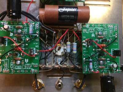

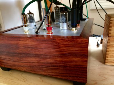

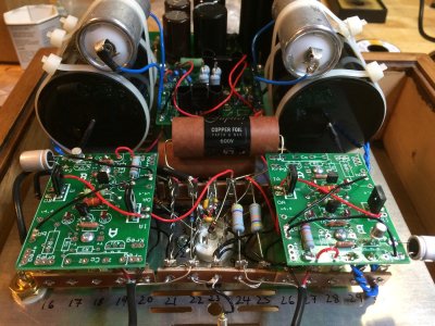

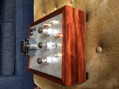

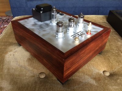

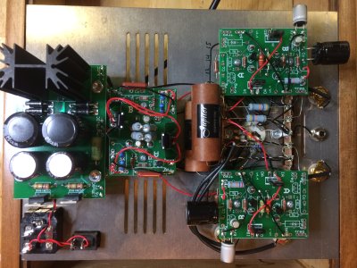

Well, I've completed the amplifier. It passed all resistance and voltage tests and is currently playing - beautifully as I may add - in my system.
I have solved the outside foil capacitor question to the best of my ability, concluding that the low impedance terminals are numbers 9 and 10. They are connected to ground through the 47K resistors.
Here are a few pictures of my build.
The base is bubinga wood.
Boris
    • Posts: 20254
Reply #3 on: June 16, 2017, 11:37:06 AM
It's kind of funny, those terminals are generally the lowest impedance to ground, but you could plug your Eros into a load that's much less than 50K, then things get switched around.

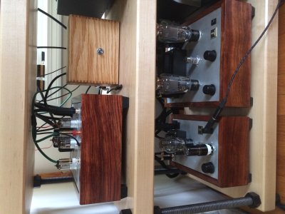

Offline borism
    • Posts: 158
Reply #4 on: June 16, 2017, 11:46:25 AM
Thanks, it is a custom bubinga base I made to complement my Bottlehead system consisting of Stereomour, Crack and now Eros.
Boris
    • Posts: 20254
Reply #5 on: June 16, 2017, 11:49:10 AM
That's a nice looking trio!
Yeah, I was going to implore you to share the details of how you could get alder to look like that!

I am also wondering if there are any sonic benefits in upgrading the 0.1 uF capacitors on the shunt regulator board. I have some Russian FT-3 teflon capacitors sitting around.
Let me know what your experience is.
Boris
    • Posts: 5898
Reply #7 on: June 18, 2017, 01:08:27 PM
I recall a long time ago hearing an improvement with the 0.056uF FT-3 caps. Worth a try if you can find room for them.
Offline borism
    • Posts: 158
Reply #8 on: June 19, 2017, 03:46:39 AM
Thanks Paul! I'll probably try it out. At this point I've put in some Telefunken EF86s and am enjoying the sound.
Boris
Offline borism
    • Posts: 158
Reply #9 on: June 23, 2017, 03:42:35 AM
One, hopefully, final step for this Eros build was replacing the electrolytic cathode bypass with film caps (Jantzen, 82 uF) and the 0.1 uF shunt board capacitors with same value Russian FT-3s. I was happy that everything fit and the amplifier works. I will need some time to hear if there is any detectable sonic benefit to this.
