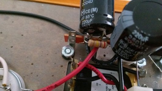

Can you post a photo of your amp?  Are you sure it's the cap that's smoking and not the 270 Ohm resistor?
I strongly suspect that your TIP50 transistors are not properly mounted to the heatsinks, as this would cause the low voltage that you're experiencing, and that low voltage will overheat the 270 Ohm resistor around T14/T15.
I would not recommend turning the amplifier back on.

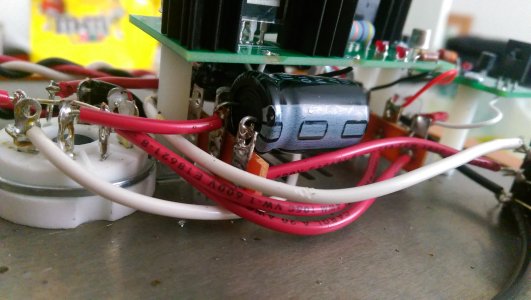

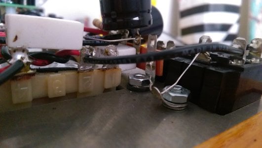

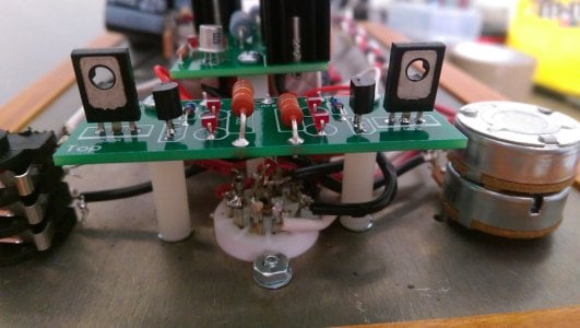

Thanks very much for the reply, attached are some pics, let me know if you need more.
After reading your post I had a closer look and there is a small hole burnt into the 270kOhm resistor, you're right.
I screwed the heatsinks quite tightly to the transistors, and was careful to follow the installation order given the warning in the manual.  Your explanation makes sense, but I'd be surprised if they weren't tight enough.
Do I just need to replace the 270kOhm resistor and recheck everything?
« Last Edit: July 25, 2017, 07:45:21 AM by cabcabaret »
Reply #3 on: July 25, 2017, 08:02:57 AM
It's the 270 Ohm resistor that smokes, not the 270K.  If you tighten the TIP50 transistors down too hard, you may damage the insulating washers and short out the collector of the TIP50 to the heatsink.  You can take your multimeter and set it to beep for continuity, then measure the resistance between the metal tab and heatsink of each TIP50.

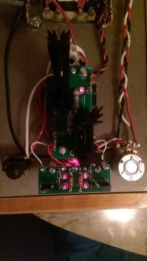

Attached is a pic of the LEDs which are on if that's relevant.
How does it look?
Reply #7 on: July 25, 2017, 11:54:23 AM

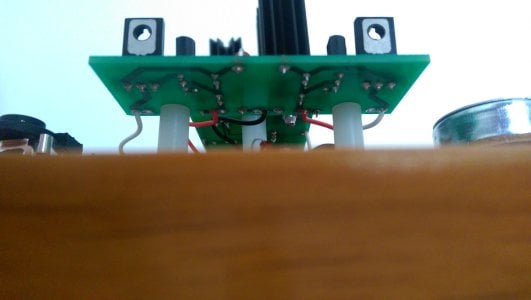

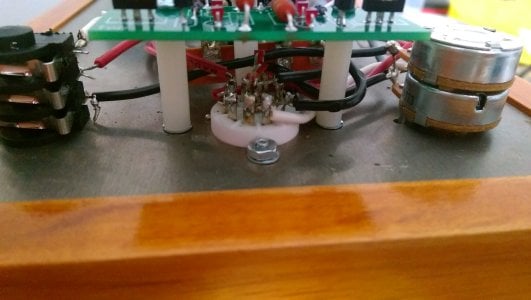

That LED on the big board shouldn't be lit up with no 6080 in the socket. Can you post a photo of the soldering on the bottom side of the big board?

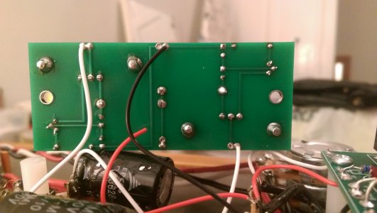

Reply #8 on: July 25, 2017, 12:08:30 PM

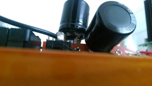

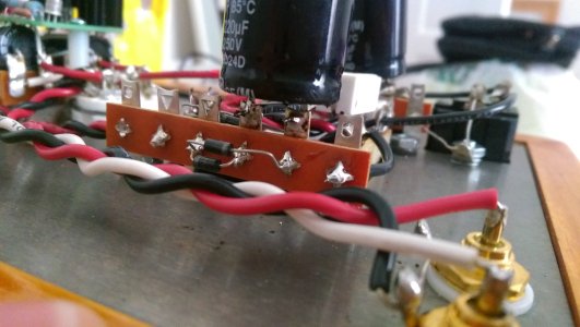

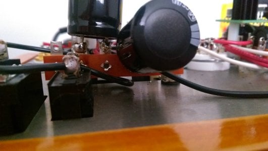

Sure, although the B+ cable broke when I lifted it of the standoffs.
The big board is sitting right on top of the caps, as I can't bend them any lower as they are.
Reply #9 on: July 25, 2017, 01:47:34 PM
I'd replace the 100uf caps and leave a little lead length. I suspect you are grounding out one LED to the metal body of the cap.

I tested that (I think) by repeating the sans 6080 check with the big board raised so that it's not touching the caps at all and the same LEDs lit up.
So I can redo the caps, but I think that means it won't solve the issue?
