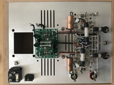

Decided to go a little custom!

on: October 16, 2017, 03:54:23 PM
A little different

Reply #3 on: October 24, 2017, 04:52:48 AM

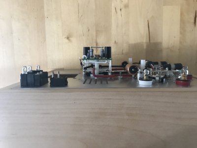

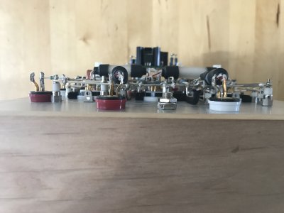

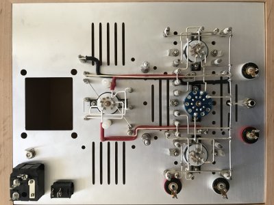

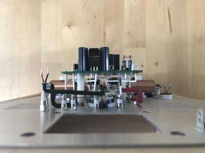

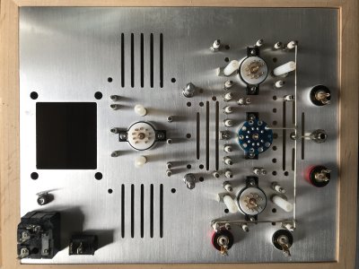

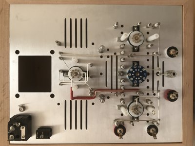

You aren't going to get any signal out of that as it's wired.
Offline 1026mind
    • Posts: 44
Reply #4 on: October 24, 2017, 04:55:15 AM
its still work in progress!

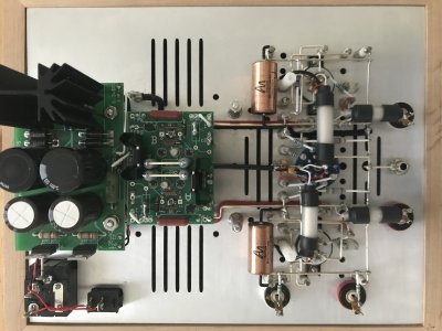

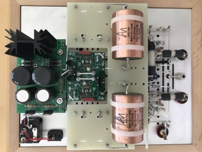

Reply #5 on: November 20, 2017, 12:15:20 PM
Its finished, the left channel has a little bit of distortion!

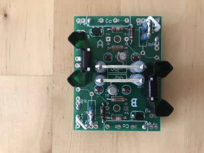

Reply #6 on: November 22, 2017, 06:19:28 AM
Solved the distortion on the left channel however when the needle is not down and I turn the volume up there is hum and interference. Please advise!
Online Paul Birkeland
    • Posts: 20282
Reply #7 on: November 22, 2017, 06:25:18 AM
If you play a record at this level, is it unlistenably loud?
I notice that there are six 0.001uF caps in your build, what are they for?
Offline 1026mind
    • Posts: 44
Reply #8 on: November 22, 2017, 06:29:59 AM
Wow! Went happy on the zeroes, it should be 3x0.01! Thank you!
Offline 1026mind
    • Posts: 44
Reply #9 on: November 22, 2017, 07:20:22 AM
I added 2x0,01, huge improvement! how high can i go with the value of that capacitor?
    • Posts: 20282
Reply #10 on: November 22, 2017, 07:22:27 AM
If this is suppose to be the 0.03uF capacitor in the RIAA EQ, you can go as low as 0.029uF and as high as 0.031uF.
