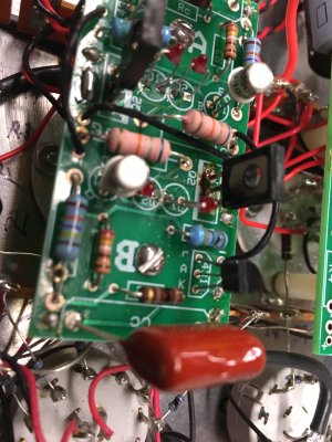

Are you able to post photos of the PC boards?
For the most part, on just about every Extended Foreplay III that I have serviced that was initially in working order, I end up building a new center PC board for the high voltage shunt regulator.
It's very easy to see if this is the issue, as the center board you have now will be a bit black under where the MJE-350s each sit.

Reply #2 on: November 05, 2017, 03:11:54 AM
This the B side MJE 350
