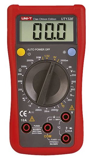

While we're on the subject of measurements; is a standard cheapo multimeter good enough for inspecting the Crack?
-the included image is of a $30-35 meter.

Reply #5 on: February 16, 2018, 01:07:38 PM
Sure, that will certainly get the job done.
