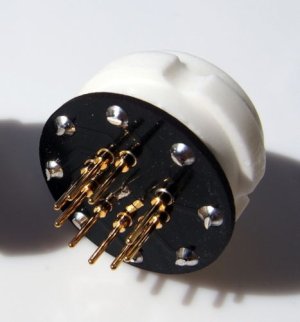

Just a couple of quick questions... besides the required pin adapter, is there any modifications required to run 6SN7 tubes? Any downsides to running one?

There seem to be quiet ones and noisy ones.  YMMV with those adapters!

Gotcha. I have one made in the USA by Garage1217. It appears to be high quality construction. I briefly tried it with a 6sn7, but the tube itself appeared to be microphonic. I might give it another go in the future.
