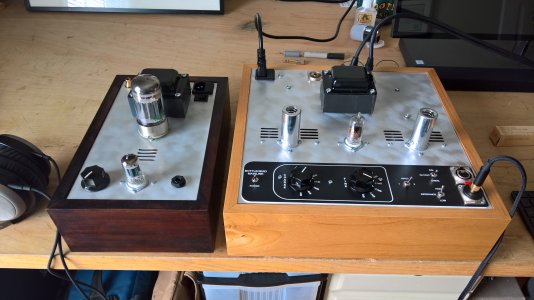

It took me a week of 4-6 hours to complete. Taking my time, chceking all the solder joints, measuring resistors, walking away and checking parts placement and directivity etc..
I actually found one resistor in the wrong location on the c4S boards! Glad I found that....the only confusing part to "ME" was these smaller pc boards, you build two of them clearly
stated in the instructions, but they install in the A side and C side exactly upside down from each other....so just be careful here...maybe its just yours truly!! LOL.
The kit had 49.9K resistors instead of 49.9 ohm resistors, a missing fiber shoulder washer, and missing 4 of the larger #8 screws that hold down the middle power reg board.
Thanks to Josh and the Queen Bee in getting this sorted out, it was a long wait here!! But it was worth it!
The tubes glowed first time, voltage checks were spot on and the biasing was set to 145 volts....with the pots in the middle of their range, the initial volts showed 180 volts or so.
There was a small high frequency noise when first turned on with headphones, some of my less expensive ATH M50's...but after a fw minutes warmup it went away..probably those tubes
waking up for the first time!..My 12AU7 has CONN on it...must be a old Conn Organ variety! Very musical!! Ha!
I checked all the inputs, switches less the balanced headphone jack, my cans are all SE.
The fit into the locking SE jack is tight, firm, etc and take some effort to remove, I imagin over time this will loosed up somewhat.
The 4 coats of the Tung Oil high gloss loks great to me, smooth and very nice IMO.

After two days and about 4-5 hours of being on...I measured the bias and it dropped to 133volts.
Re-adjusted to 145 volts.
I do the biasing after the amp is on for 30 min or more...
Most likely this is normal..still sounds real good
