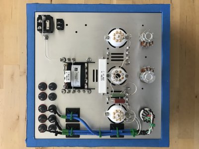

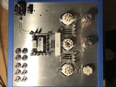

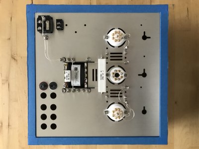

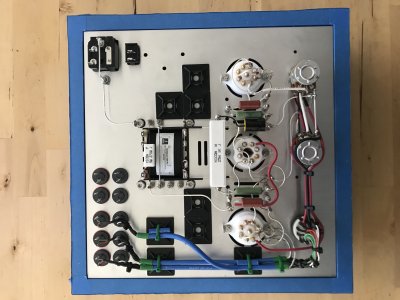

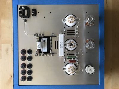

I am starting a new project, please feel free to post your feed back!

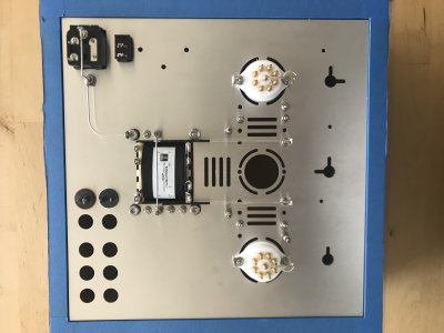

What are those tube sockets?  They don't look like they have solder lugs.  How do you solder pins like these?
Offline 1026mind
    • Posts: 44
Reply #2 on: April 03, 2018, 11:27:41 AM
They are Yamamoto Teflon sockets, you solder them just like the turrets!
« Last Edit: April 17, 2018, 08:26:08 AM by 1026mind »

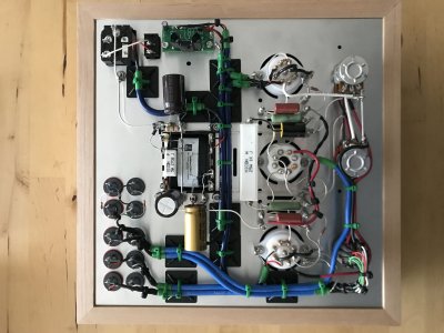

checking voltage and i have very low reading on A4 and A8 and B4 and B8, also led don't ligtt up!
« Last Edit: April 23, 2018, 10:34:50 AM by 1026mind »
    • Posts: 20305
Reply #9 on: April 23, 2018, 11:39:22 AM
How about the rest of your voltages?
Offline 1026mind
    • Posts: 44
Reply #10 on: April 23, 2018, 01:11:59 PM
solved, the two outside socket where mounted 180 degree off!

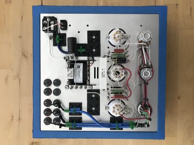

Any pictures of the finished preamp? I would really like to see the underside. Based on your initial pictures it is probably one of the cleanest builds I’ve seen.

Reply #13 on: April 25, 2018, 06:42:45 AM
That is very tidy. Nice job.
Now I have an idea of what is possible when I build mine.
