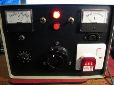

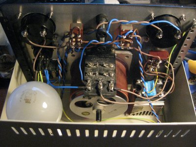

Reply #2 on: July 25, 2018, 02:04:15 AM
I got fed up with variacs, light bulb limiters, and meters all over the desk so i built them all into one enclosure.  With the flick of a switch i can take the variac or limiter out of the circuit while the connected device is running 8)
If you are restoring old gear a variac and limiter is a must have.  Even building amps from scratch i highly recommend using them for the first power up, it has helped me catch a few mistakes in the past before i fried something.
