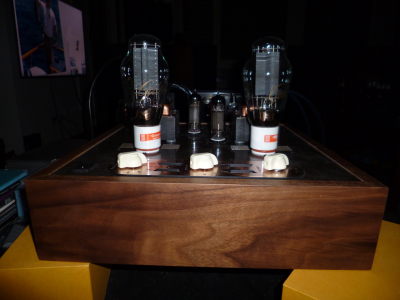

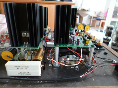

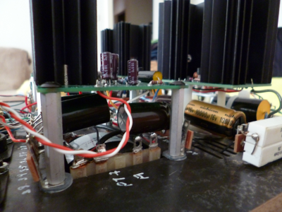

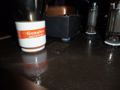

Hello
Have replaced the hard washers with alpha gel washers. Now the transformers and the regulator board are floating on the aluminum plate. Off course isolated and grounded. Amazing how calm the Bee Pre plays now. For this, a huge sound profit. :)
Loudspeaker: Voice of the Theatre with Western Electric WE 555 KS6368
« Last Edit: September 21, 2018, 09:31:03 AM by Felice »

Reply #5 on: September 28, 2018, 01:30:41 PM
pictures
4krow
Reply #6 on: September 29, 2018, 03:25:43 PM
  Thanks for the clear photos. Vibration suppression comes up in some of my projects/experiments, and there have been times that I went to great lengths to control it. Sorbothane 'T' washers, along with matching 'O' Sorbothane washers did the trick for me, but I do appreciate ideas of this nature as well. One consideration is the torque or tightness of the attaching bolt or screw, so as not to 'squish' all the goodness (load rating) of the washer being used.
