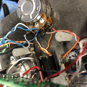

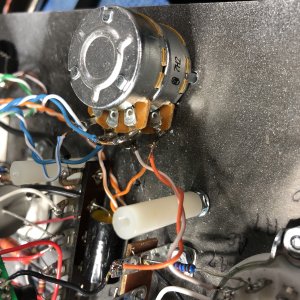

After grounding issues I saw in this thread, I ran a new pair of orange twisted wire parallel to the CAT5 already in place from the right input jack to the potentiometer which seemed to resolve the issue. Then I went away for two weeks for work, came back, and had an even worse sound problem on the right hand side.

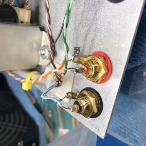

I ran all the resistance checks. Everything was fine except the middle pin of the RCA jack. I reflowed that joint, which didn't solve the problem. I replaced the other orange pair from the tube to the pot and that didn't solve it either. At this point I'm wondering whether it's the pot or RCA jack itself, or if I've had a run of broken CAT5, or if I am truly garbage at soldering or what.

At the center pin on the right RCA the reading was over limit.

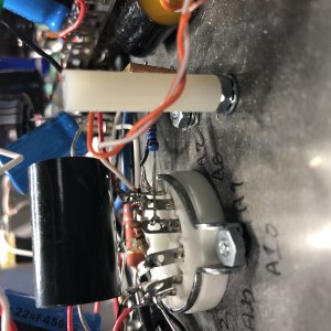

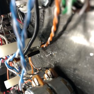

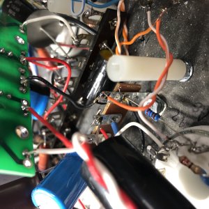

Alright, well... I'm still seeing issues. The left channel is fine, but the right channel sounds like it's under water. Very muffled. If I poke around, the only thing that is making noise is the pins toward the front of the chassis.
Here's what I've done so far.
  • I scavenged the A100K pot from my Stereomour kit and installed it.
  • Replaced the orange striped pair from the pot to the tube and the terminal strip.
  • Reheated the joints on any pin that made noise when I poked it, specifically A8, A9 and A10.
I'm kind of at a loss at this point. Am I missing any potential causes? Should I just rip out the right side around the tube and start over?
