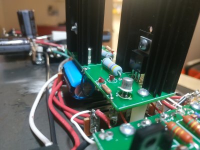

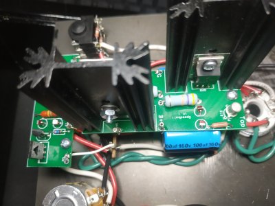

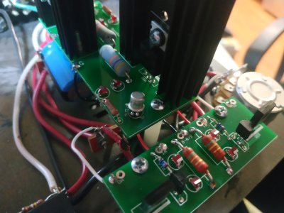

Hi,
I'm almost done assembling the speedball upgrade. Voltage on the small board were all good. Resistance on the big board were reading around 25MΩ or OL. I guess it's good since it's supposed to be very high.
Voltages on the big board are wrong however. G and B+ are good, but OA and OB read respectively 123V and 107V. All led are lit.

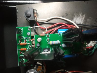

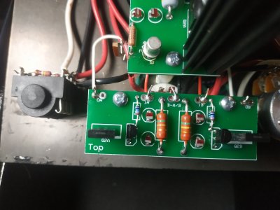

Any idea what could be wrong here ? I attached photos of my boards.
Thank you !

What are OA and OB on your small board looking like?
Reheating the joints on the big C4S board never hurts when it isn't working properly.

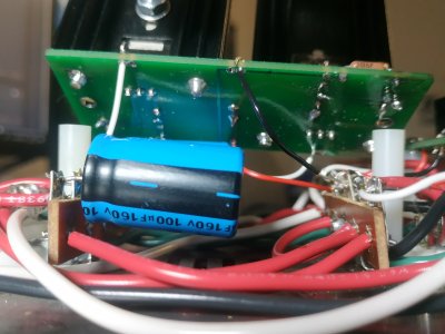

Could you post some updated photos of the build?
The 107V isn't a problem, but the 123V is a bit out of range.

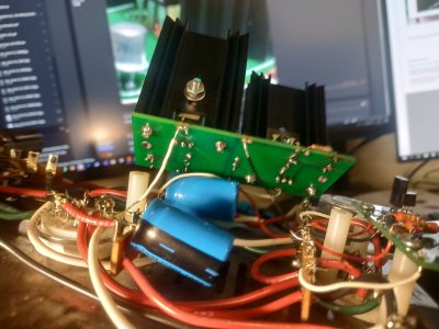

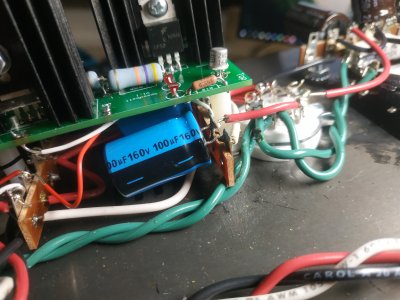

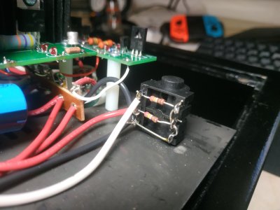

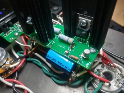

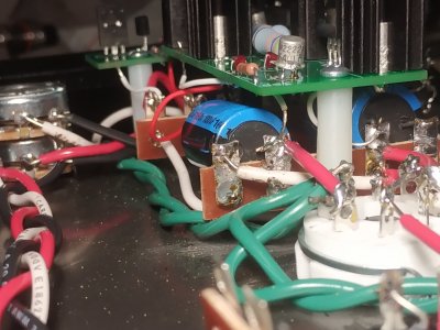

Sure, here you go ! Let me know if there's something in particular you'd like to see.
I should probably mention that I messed up with one 2N2222A transistor (the one near OA) and had to desolder it and reorder one on digikey. I got this one : https://www.digikey.com/product-detail/en/central-semiconductor-corp/2N2222A/2N2222ACS-ND/4806845
The desoldering part was not easy to me, and it's entirely possible that I did something wrong here.

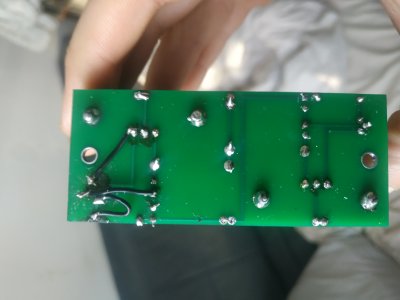

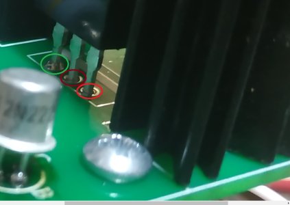

Edit : added a photo of the underside. I can't do any better without either desoldering the wires or cutting them, Let me know if you need it !

    • Posts: 20295
Reply #6 on: November 20, 2018, 04:06:24 PM

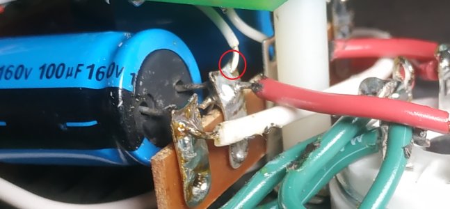

These are still not soldered all the way.  You may need to hold the iron on these joints much, much longer, but one of them does look good.
    • Posts: 20295
Reply #7 on: November 20, 2018, 04:18:04 PM

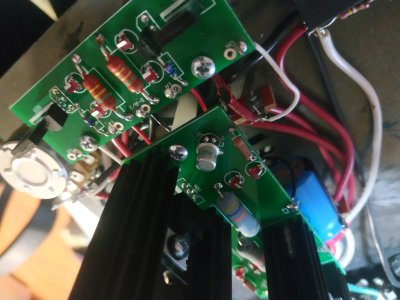

Here's another one.

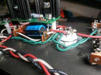

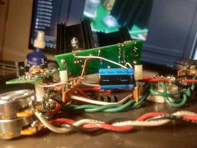

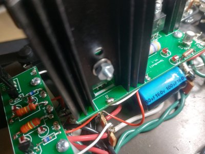

So I resoldered the joints you mentioned and I rechecked the other joints. Still no luck, I still get around 124V from OA and 104V from OB. I attached some updated photos.

The 100uF caps discharge through the 2.49K resistors on the headphone jack, or through the solid ground connection on the headphone jack itself.  If these are not discharging, then there's an issue with the build that was present before you installed the Speedball.
There are still some solder joints where the solder isn't wicking all the way up through the hole.  It also looks like the wire going to B6 isn't soldered well at B6.

Follow the wire leaving OA to the terminal strip, then to the tube socket.  I would bet the wire between the terminal strip and the tube socket isn't well soldered.

Reply #12 on: November 22, 2018, 12:10:34 PM

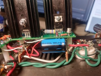

I resoldered the capacitor. It was hard to bend the legs because they were inserted from the other side. Now it's much easier to bend them out of the way for the big PCB. I also went and added some solder to the joints on the way to the tube socket, to the headphone jack and the ground near the power socket. It's no use, the transistor is still fully charged when unplugging the amplifier. I attached some new photos I made after resoldering all that.
    • Posts: 20295
Reply #13 on: November 22, 2018, 01:51:06 PM
That's still looking cold.  You want to see the solder flow around the wire.  If it doesn't, the flux will float to the top of the solder and insulate the solder from the wire if the solder doesn't flow all the way around it.  More heat is the answer here.

Hello again !
I resoldered the joint you mentioned. Should look much better now. I attached a photo.
