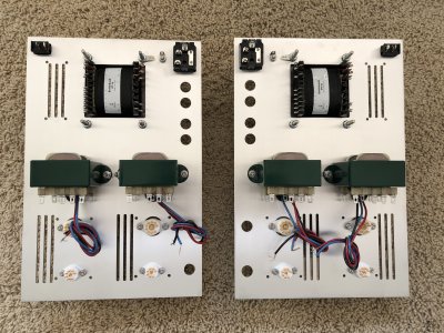

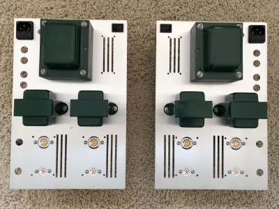

Please help me if you see any errors, I will post pictures with the progress of the build.

Mirror imaging can be pretty tricky, be sure to build the stock one first and get it up and working before getting too far on the one that's flipped around.
I would also not recommend those particular tube sockets, as I've seen a lot of them come in on kits that need repair.  They are difficult to work with since they have posts but not eyelets, and the 9 pin one doesn't fit properly.  There are gold/ceramic versions of the sockets we provide that fit perfectly.
Have fun with the builds!
