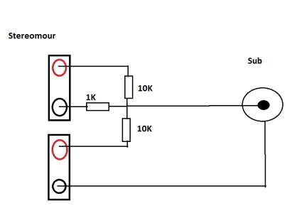

Paul - my woofer has one line level (RCA) input. I currently have a two to one (stereo to mono?) RCA cable running from the Apt to the woofer.
For nearly all preamps, this will make your stereo signal into a mono signal (so the signal going to your amps will be L and R for each amp, not good).
To fix this issue, I made you an ugly drawing that you can implement to restore channel separation.  Resistor wattage isn't important.

Reply #7 on: January 08, 2019, 04:13:43 AM
Paul - You are so right! I was trying to test some news drivers yesterday and couldn't figure out why my balance seemed to no longer work. Thanks for the drawing, super helpful.
