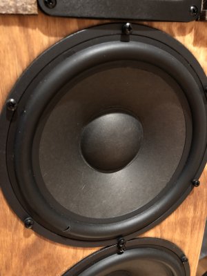

I have cats. They have claws. One of them damaged the speaker. Is it possible to repair this, or is this a replace? It’s on the rubber, is there a glue that works for this?

Like the rubber around the woofer surrounds? I would just replace the woofer, that's not the easiest place for glue to hold up.

Yes, that is it. its the rubber gasket at the end of the cone that attaches to the front metal ring. It is the part that is the flexible seal to keep air in and sound on the outside.

It's called the surround. You could try some silicone sealer but as PB says it may not hold up. I would try it and if it doesn't work, get a replacement driver.

More specifically, black or red RTV available at your local auto parts store, not bathroom caulk.

Madisound might be able to repair that but it's possible that it might cost as much as a new driver once you pay for shipping both directions.

If a DIY repair won't hold I'm pretty sure the most cost effective approach will be to replace the woofer. We can provide info for a replacement if that is deemed necessary.

If the damage is slight, I have used a dab of rubber cement to seal small tears

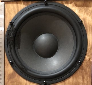

I have converted the images and am uploading them of the before and after. I used the black RTV.

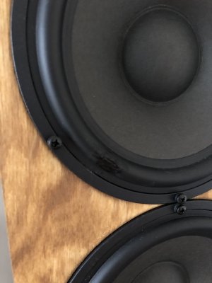

well it turns out that they did it again and more extensively this time. Ill be trying to order a replacement speaker and will try the grills.

I wanted to add an image of the second repair of the damaged speaker. It is a mess, but the rubber gasket maker material holds my cat's shame all together!

This is not a huge deal, but that looks like it is the upper woofer. The lower woofer has less of the upper frequency range to cover. If the lower woofer has escaped damage it might work a little better in the upper position.
Note that this is based on assumption and is purely speculation.
