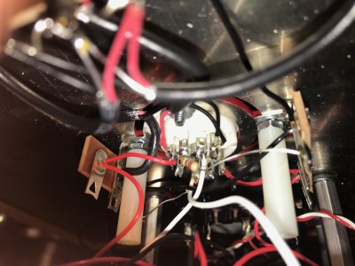

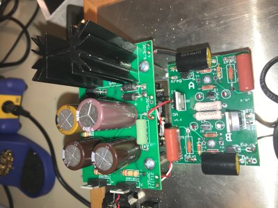

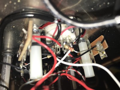

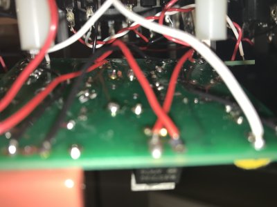

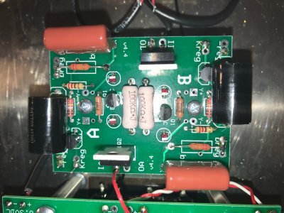

That is a bit of a problem.  If it's not too much trouble, could we review some photos of that area of the build?
Offline armaloney
    • Posts: 9
Reply #4 on: February 06, 2019, 05:27:55 PM
I've attached a few here.  Any views you want to see in particular?
Tried to get underneath as best as I could, but would need to disconnect some wires to really get it.  (I actually broke the wire from the +275V pad on the power supply trying to get underneath.)
