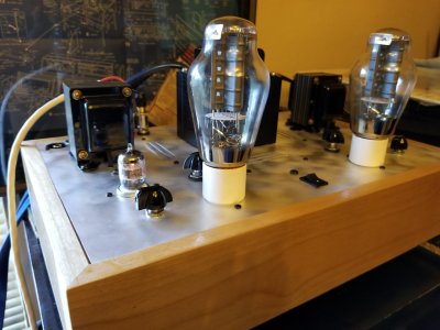

Thank you PB for a great build.  It would've taken me a month of good days to get this done.  Got 5 (5.1 and 5.7 mv) for hum.  I will listen for awhile to see if the DC filaments are needed. Now realize I must retire some amps to the garage.  Well, it's time I simplified my setup.
Now for burn in and speaker selection and tube swapping...

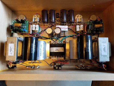

I'm glad it made it safely! How did that expanding foam cradle work out?
I got pretty lucky with all those big caps, there's only about 1/16" of clearance left between the lowest hanging caps and the counter top.

The expanding foam is a good idea, kept everything stable (along with the metric butt-ton of packing peanuts).  I see what you mean by the chicken head knobs, I replaced them with the larger set but they still sit too high, will change to black knurled knobs.
I got a pair of GE 5 star 5670's, should I check the driver voltage (175v) at each tube swap?

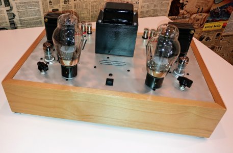

Pretty cool.
It looks like the plate chokes are mounted on standoffs - assuming this is the case, is this for ease of wire routing, or does it serve some other/additional purpose (e.g., additional distance from the OTs above)?
Derek
    • Posts: 20282
Reply #4 on: May 15, 2019, 05:02:53 AM
If the driver plate voltage is off by a few volts, it isn't going to be particularly audible.  If you plan to roll a lot of driver tubes, you could just set each cathode at about 4.2V and not worry about it till you have the pair you like.
The chokes are mounted on standoffs because the output transformers have been changed from our OT-5 to a pair of TFA-2004.  In order to keep each TFA-2004 centered on each 300B, the transformer leads needed to pass right through the space now occupied by the plate choke, so I spaced them up off the chassis.
