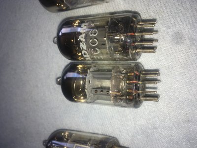

In the Philips ECC81 collection i've seen:
Delta -> Heerlen (The Netherlands)
R -> Mitcham (England) (Mullard)
B -> Blackburn (England) (Mullard)
D -> Hamburg (Germany) (Valvo)
‡ -> Munich (Germany) (Siemens)
F -> Suresnes (France) (La Radiotechnique)
I've added an example. It's an Adzam (Belgium) labeled, Mullard Blackburn factory build, ECC81 pair (three holed plates are typical for certain versions of ECC81 build in this factory).

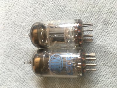

Sometimes these were relabeled ECC801S in Europe. An ECC801S tube is build within the 12AT7WA/6201 spec. But not every 6201 is a ECC801S tube.
Here's a ECC801s (Valvo) from my collection that's build like a Valvo 6201, and a telefunken pair for comparison.
https://ep1.pinkbike.org/p5pb17201911/p5pb17201911.jpg
Telefunken ECC801s datasheet: https://frank.pocnet.net/sheets/117/e/ECC801S.pdf Do note the long life heater specs the 6201 are missing.

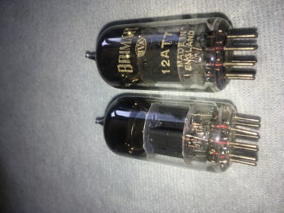

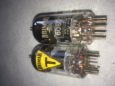

So! Another tube to roll in SII.
Aside from Philips and Telefunken there's a few other interesting EU tube manufacturers.
The American International Telephone and Telegraph company ITT (Western Electric) had two known subsidiary companies; Brimar (British Manufactured American Radio) and Lorenz (Germany).
The 6060 is an 12AT7 special version from Brimar with square black plates. The ones with the "yellow-T" on the back would be the "special quality" versions according to the internet. The CV4024 (CV=Common Valve, a military designation) is a military designation of this tube. Beware CV4024 is also used for Mullard military Ecc81's.
Other names for a Brimar ECC81 (see below) are CV4033 and 13D9 (these are less known names and can be found for less money because of this).
From the Lorenz company i've found many relabeled versions. Some are called Lorenz, ITT, SEL, others have just written the tube type on them. Common with a lot of these is extra mica supports. And they are physically obese/large compared to ECC tubes from other companies (though not as fat as Tungsram, but close).
From my experience with ECC82's, tubes from these companies are, while found for less money, just as good sounding as other manufacturers'.
